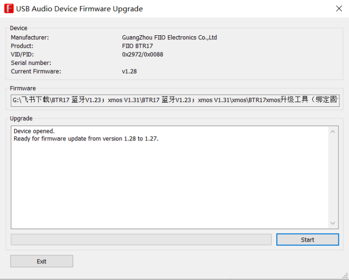

3. Double-click to open the "FiiO_Dfu_BTR17" upgrade tool, as shown in the figure below:

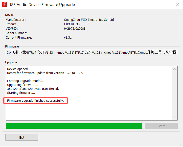

4. Click "Start". When "Firmware upgrade finished successfully." is displayed, it means that the XMOS firmware upgrade is successful.
