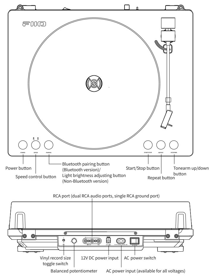

First installation notes:
1) When installing the turntable platter, ensure it rotates smoothly and evenly.
2) To remove the stylus protector, gently push it outward.
3) Pay attention to the two main parameters of vinyl records:
a. Size: Supports 7-inch and 12-inch records. The TT13 has a selector switch on the rear panel—set it to the correct position.
b. Speed: Vinyl records typically indicate their speed. The TT13 supports 33 RPM and 45 RPM.
4) TT13 output support
RCA output
Bluetooth transmission (Bluetooth version only)
5) TT13 power supply
Supports both 12V DC input and AC power (switchable).
TT13 buttons and ports labeled
