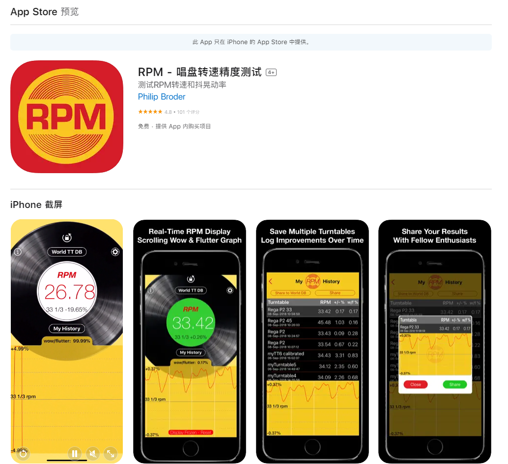

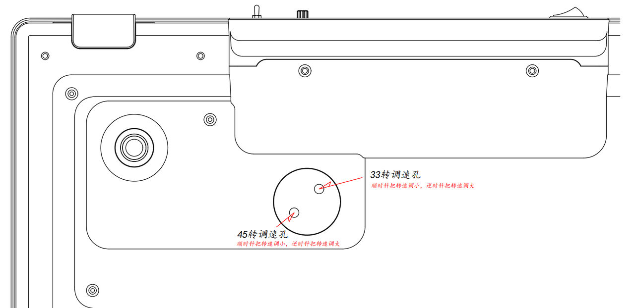

3) How to adjust rotation speed?
TT13 has speed adjustment holes on the bottom. Users with technical skills can adjust the speed through these holes (not recommended for non-technical users).
An app recommended for speed adjustment (for reference only)

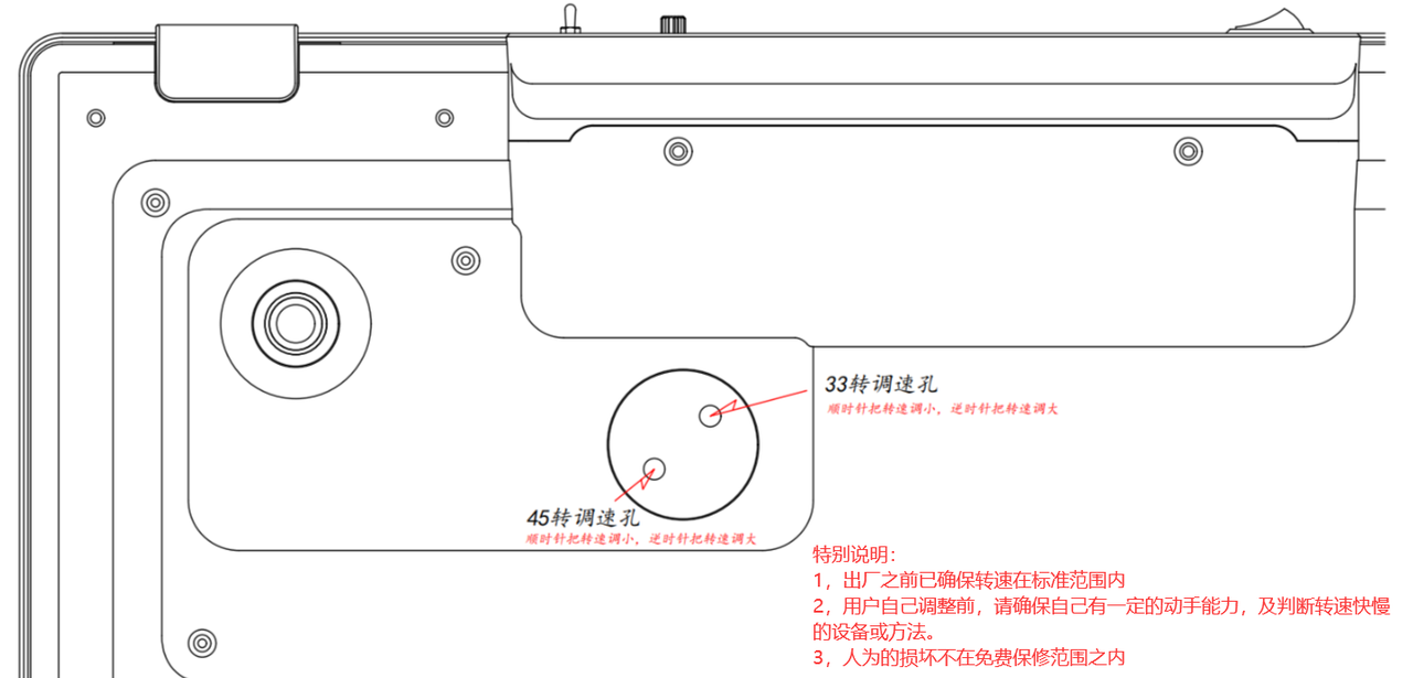

4) What to do if the stylus isn't on the record or even falls off when playback starts?
Note: The first batch of 2000 silver TT13 turntables is not applicable to this adjusting method.
