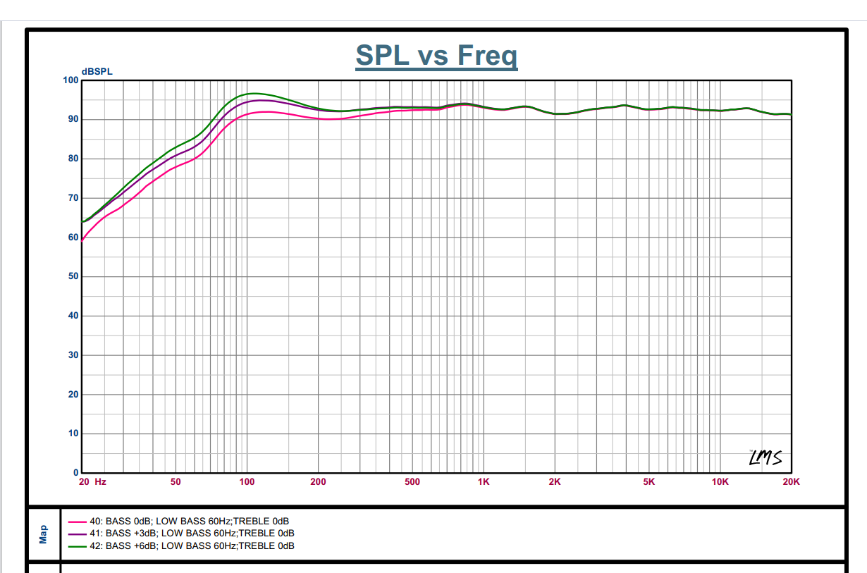

The bass gain adjustment offers three levels: 0dB, +3dB, and +6dB. For details, refer to the test curve.

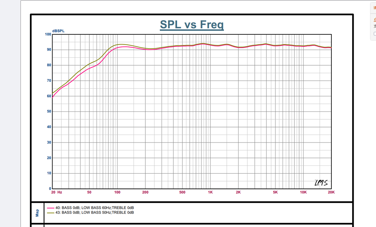

The bass extension adjustment offers two settings: 50Hz and 60Hz. The 50Hz setting allows the speaker to achieve greater low-frequency extension. For details, refer to the test curve.

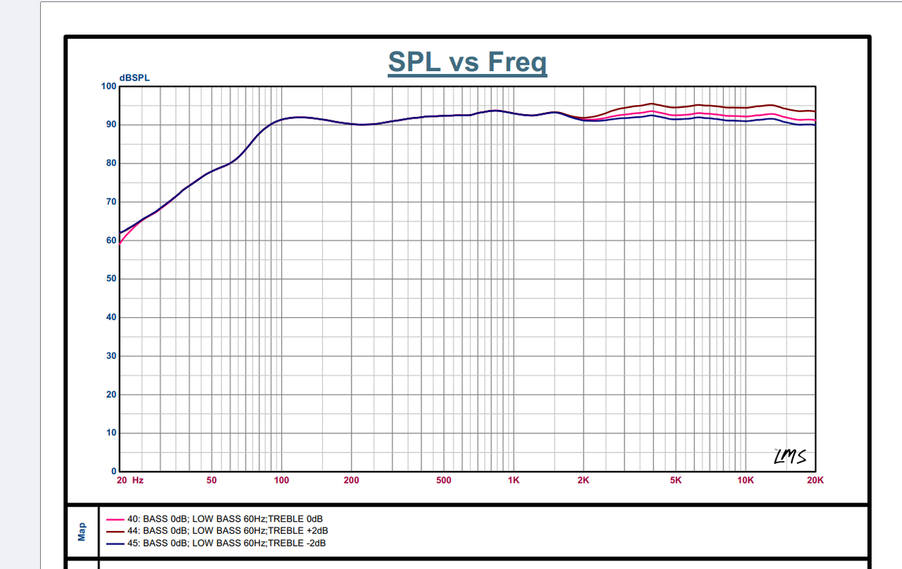

The treble gain adjustment offers three settings: +2dB, 0dB, and -2dB. For specific adjustment effects, please refer to the test curve.
