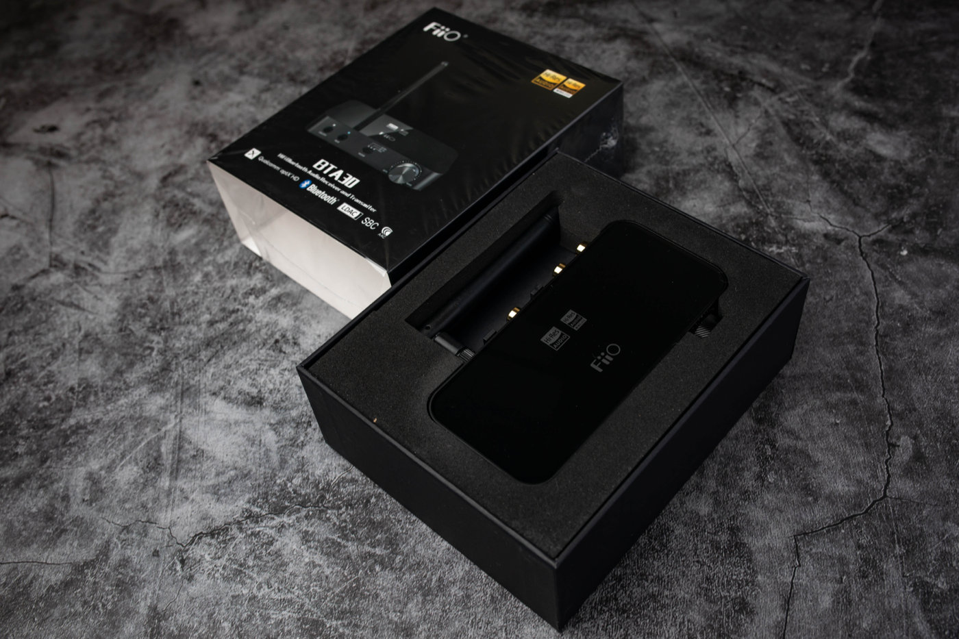

then let's take a look at unpacking first ~

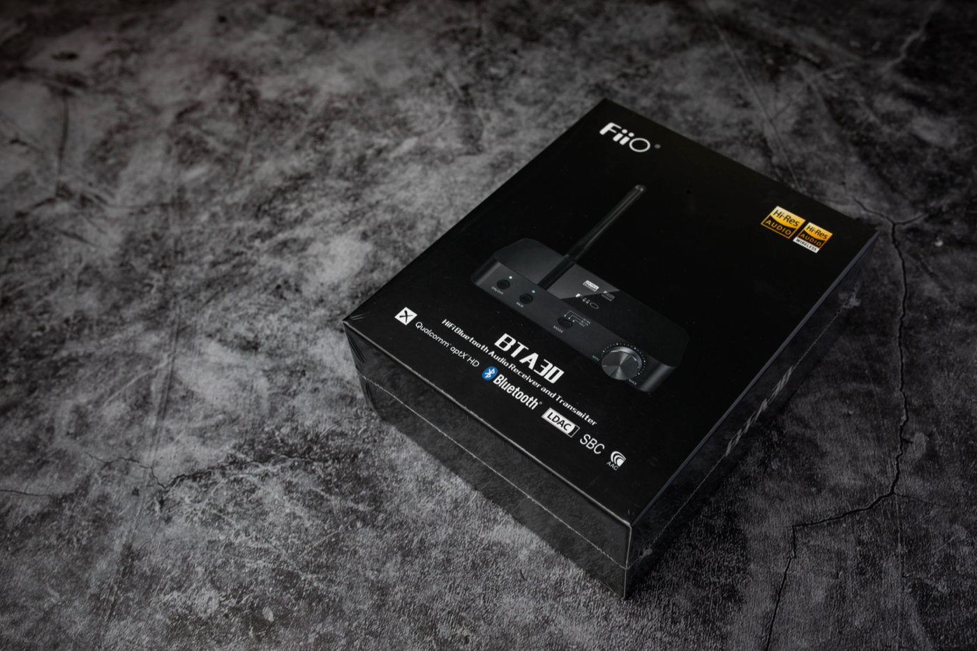

outer package
back

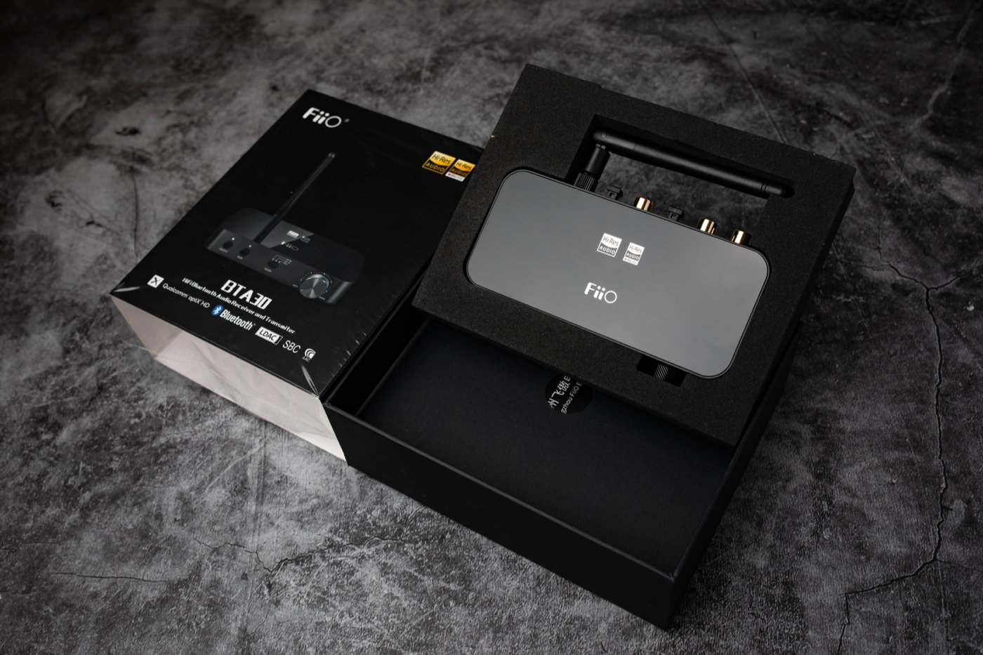

内盒,BTA30本体Inner box, BTA30
lift it up and have a look

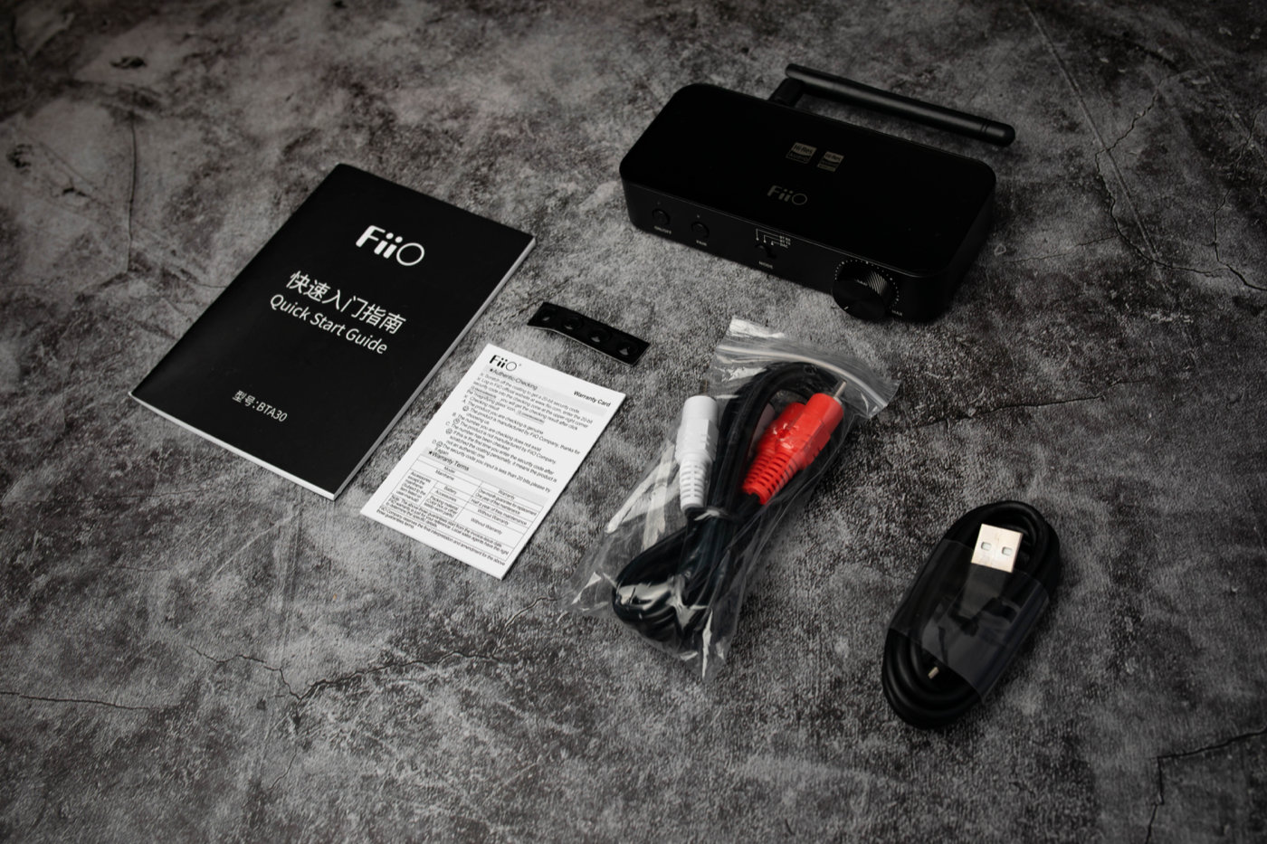

family photo

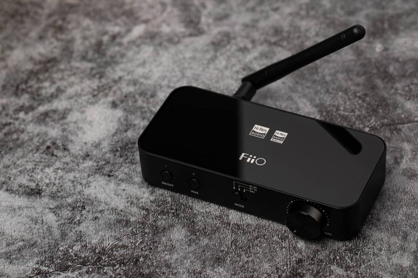

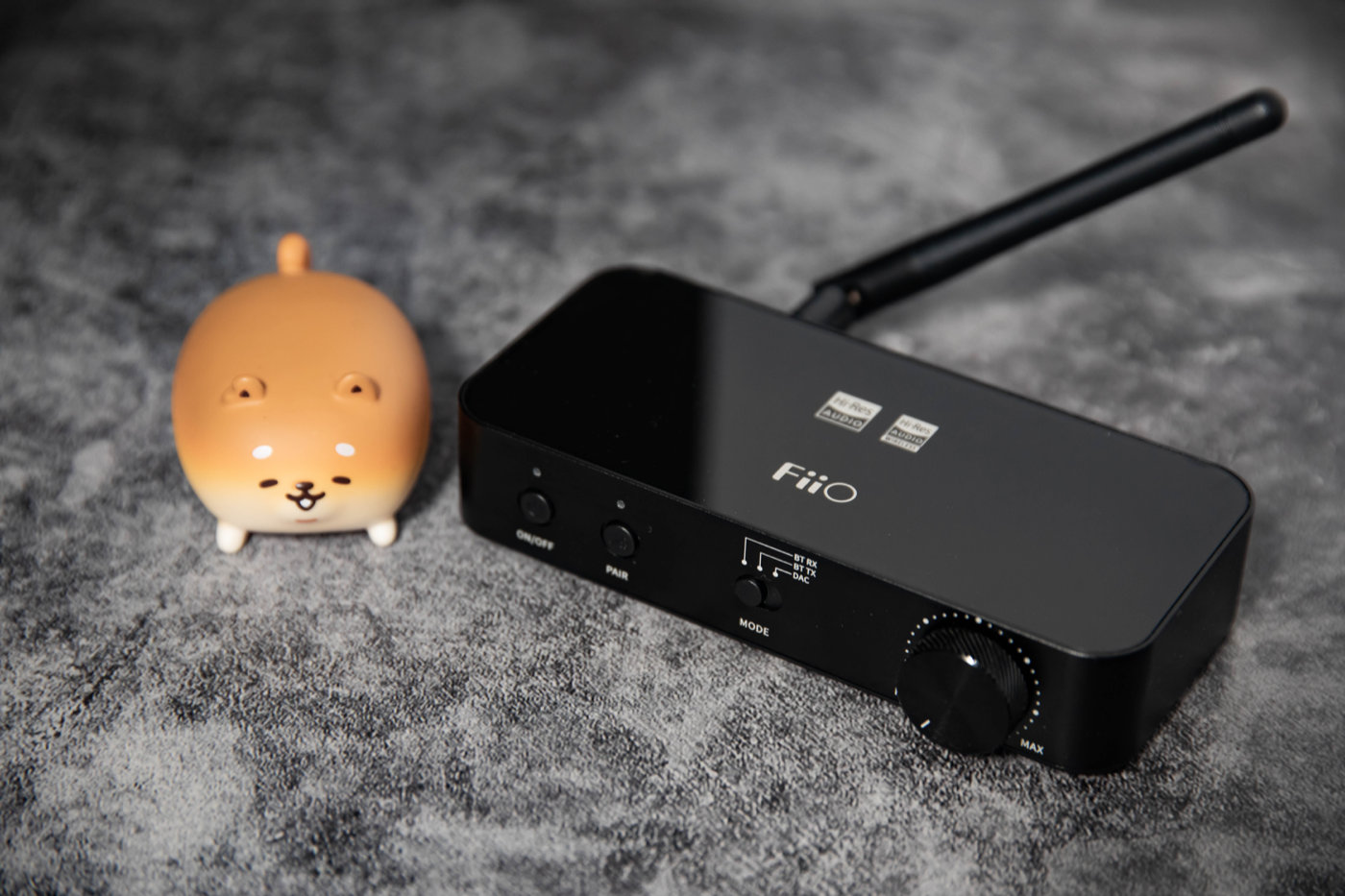

body close-up
BTA30 body shell is made of high-strength aluminum alloy material, and the texture can be said to be quite good. Compared with the metal frosted texture, the body BTA30 is matched with a bright acrylic top version, and shows the brand logo and two "small silver labels" certified by dual Hi-Res Audio, which is low-key and not low-key. In terms of accessories, the instructions, warranty card, data line, RCA signal line, etc. have nothing to say, but the attached foot pad can be very humanized, with emphasis on praise ~

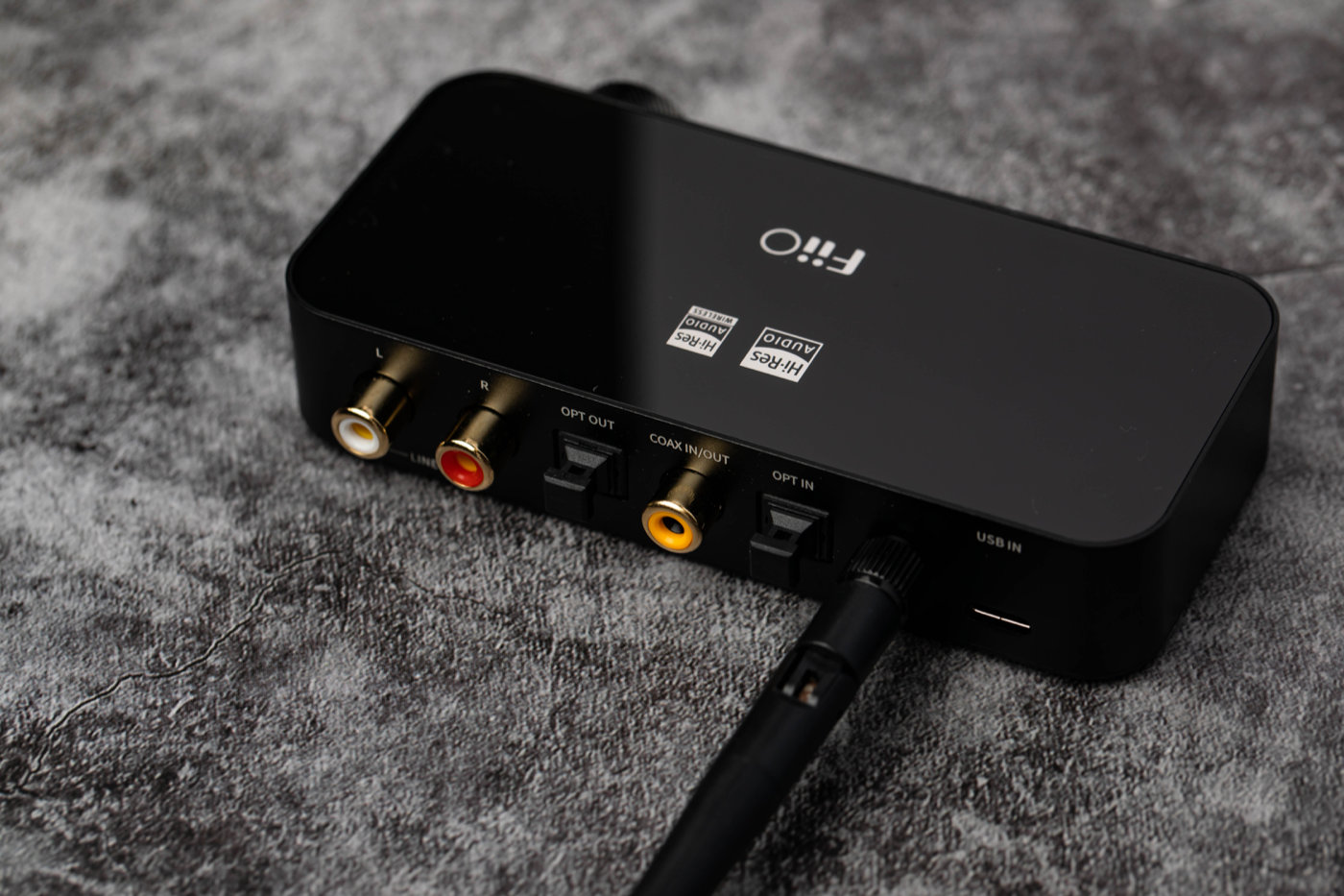

configuration, BTA30 is equipped with high-pass CSR8675 low-power Bluetooth chip, which supports Bluetooth 5.0, 24bit audio processing and 120MHz DSP. At the same time, BTA30 is also a desktop Bluetooth decoding/SPDIF system with an independent high-performance DSP chip, namely CT5302, which can upgrade digital audio to 192k for better listening experience. In addition, in order to give full play to the transmission performance of the CSR8675, the external gain antenna of BTA30 can achieve the effect of faster connection speed and more stable transmission. The analog part of BTA30 is specially equipped with an independent DAC chip, AKM AK4490, which supports native 384k and DSD hard solution. Compared with the DAC of Bluetooth of similar competitors, it can be said to be a qualitative improvement. The op amp part adopts OPA1662, and at the same time, a thin film capacitor is added to adjust the sound, making the high frequency part more transparent. In terms of interface, BTA30 has RCA analog output interface, optical fiber output interface, optical fiber input interface, coaxial output/input interface, Type-C USB interface.
Close-up of BTA30
