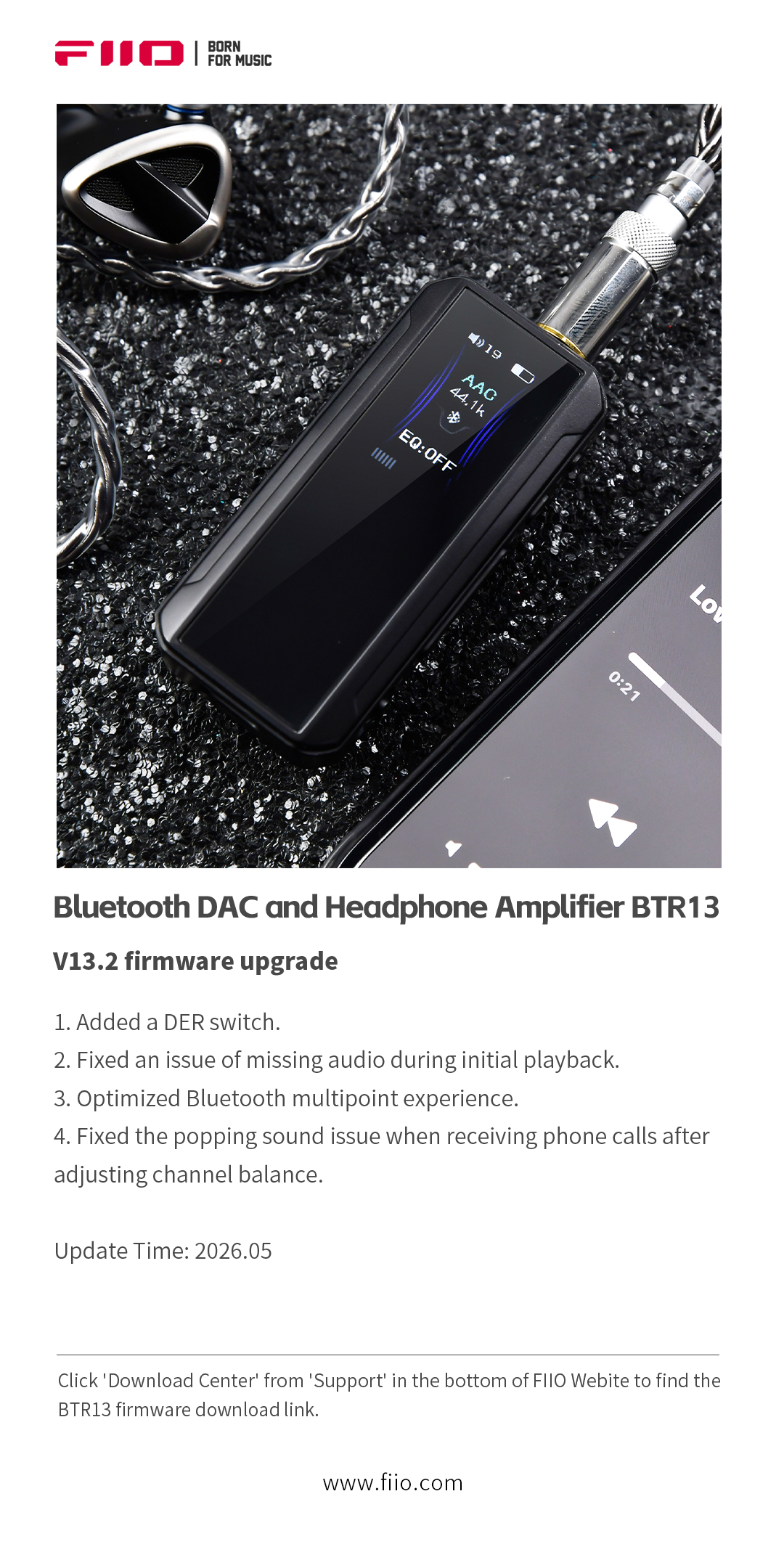

The new firmware V13.2 for BTR13 is now available!
How to update the Bluetooth firmware for BTR13:

BTR13 v13.2 firmware download link: Click here
