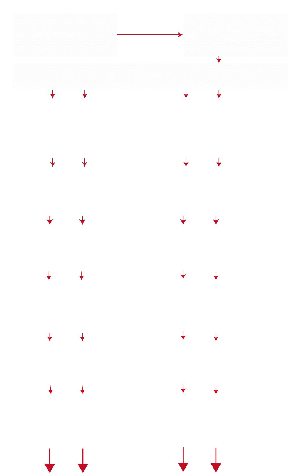

The entire signal path—from the R2R DAC and LPF to the volume control— uses full-differential signal handling, resulting in low noise, minimal distortion, and large dynamic range. Furthermore, it is equipped with a pop noise elimination system, which further guarantees the integrity and robust nature of the audio circuitry.
Fully balanced audio circuit

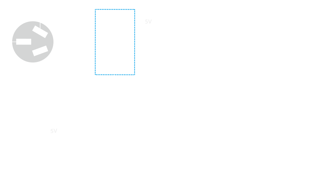

AC/DC dual power supply design
The internal high-quality switching power supply ensures the device is fed with clean power. It is also equipped with an external DC power port*, giving you the flexibility to pair the device with a high-performance linear power supply and unlock a new sound.
*When using external DC power, ensure the power supply provides 5V output, ≥2A current, and uses a 5.5×2.1mm jack.
*The device automatically switches to prioritize DC power when a DC source is connected.
