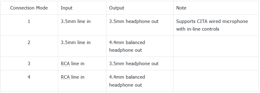

Inputs and outputs
Note: The 3.5mm headphone output and 4.4mm balanced headphone output can be used simultaneously.
