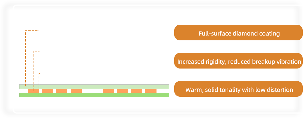

The ultra-thin diaphragm delivers greater compliance and lower distortion, producing smooth, refined highs that remain comfortable even over long listening sessions.

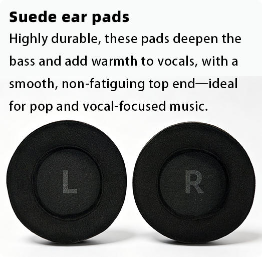

Two sets of ear pads included

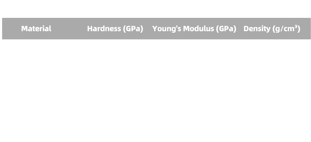

The FT15 incorporates FIIO's self-developed patented multi-layer coating technology*. The voice coil features a silver-aluminum alloy coating to enhance its mechanical performance and conductivity, while the diaphragm employs an innovative full-surface diamond coating. Using a highly sophisticated manufacturing process, this design brings the unique physical properties of diamond into the acoustic field. The diamond material used in FT15's coating offers greater hardness and structural stability—the same properties that make it a common choice for tweeter diaphragms in high-end loudspeakers. Applied through a vapor deposition process, this coating forms a stable reinforcing layer on the diaphragm that reduces high-frequency breakup and improves response speed, extending frequency response up to 40kHz. Because the coating resists decomposition and fatigue even under prolonged vibration, it maintains consistent acoustic performance over the long term. A vacuum high-temperature treatment further tunes the substrate's natural frequency, lowering its resonance point for deep, powerful bass extension.
*Patent number: ZL2024205488218
*Compiled primarily from public materials databases, technical literature, and industry standards. Actual values may vary depending on manufacturing process; figures above are provided for reference only.

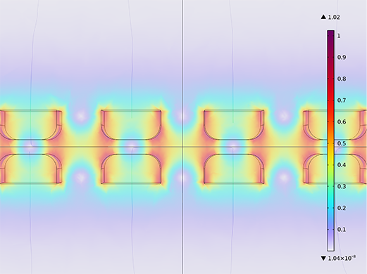

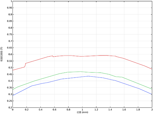

Traditional rectangular magnet designs create uneven magnetic field distribution, which can often lead to diaphragm breakup vibration and distortion, compromising the sound. The FT15 features FIIO's specially developed patented uniform magnetic field technology*, combining custom-shaped high-strength magnets with precisely optimized magnetic circuit alignment to create a highly uniform magnetic field. By driving the diaphragm evenly and synchronously across its entire surface, the design helps suppress breakup vibration and distortion at the source, faithfully preserving the details of the original sound.
*Patent number:ZL202420884963.1
Synchronized response, Every last detail intact Patented uniform magnetic field design

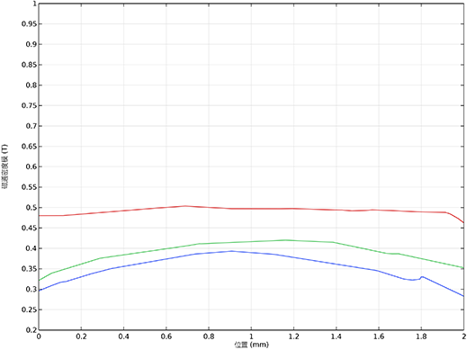

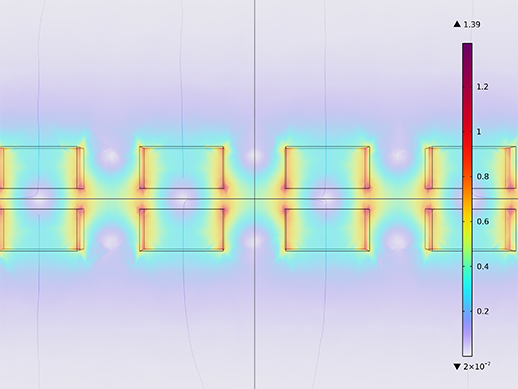

With a conventional magnet design, as shown in the illustration, the magnetic energy is concentrated in a narrow effective field. That limited coverage greatly reduces the area available for the drive coils, so the diaphragm does not receive enough driving force and driver sensitivity is directly constrained. The magnetic flux is also uneven. Coil traces in stronger and weaker regions experience clearly different forces, which readily causes diaphragm breakup and leads to higher distortion.
The FT15 magnets are precisely tuned through finite element analysis. Magnetic flux is distributed more evenly, the effective field covers a wider area, and the coil driving area is greatly increased. The diaphragm is driven more fully, raising driver sensitivity. Along the diaphragm’s direction of motion, the magnetic field remains highly consistent. At different excursion levels, force on every part of the coil stays even. Nonlinear breakup is suppressed at the source, and harmonic distortion is significantly reduced.

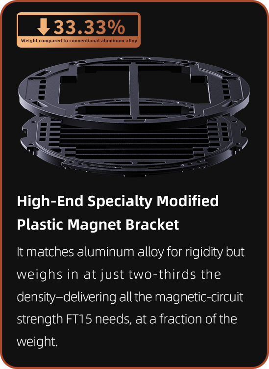

Weight-reducing materials prove planar headphones can be light
425g lightweight design
To overcome the traditionally heavy weight of planar headphones, the engineers carefully optimized the material selection, structural design, magnetic circuit, and other aspects of the FT15, bringing the total weight down to 425g—significantly lighter than comparable planar headphones. Less weight, without compromising quality.

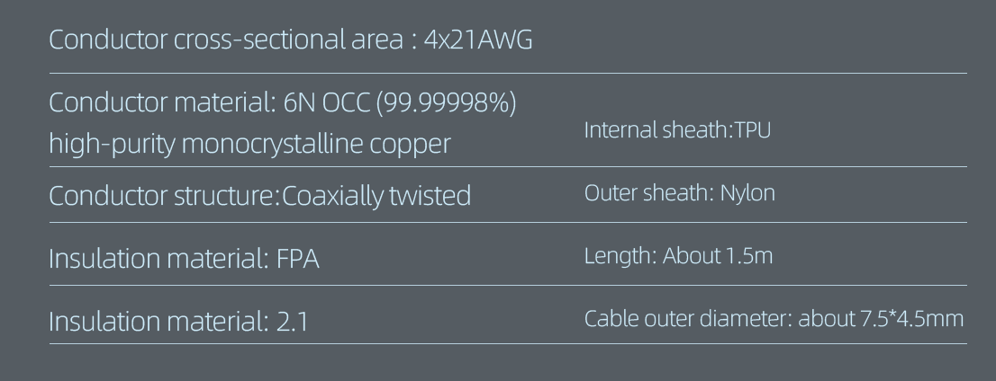

The FT15 uses 6N OCC single-crystal copper with a purity of up to 99.99998%, offering no grain boundaries, low resistance, and high electrical conductivity. These properties help reduce interference from oxygen and hydrogen impurities during signal transmission. Each conductor undergoes 100+ hours of -192°C liquid-nitrogen cryogenic treatment, releasing internal metal stress and optimizing its microscopic structure. This allows the signal to travel with effortless smoothness and revealing clearer, more distinct sound. The FPA insulation further applies a subtle tuning to the mid-low frequencies, adding just the right amount of coloration so the timbre comes through transparent yet open and relaxed.
*The cryogenic treatment applies to the core copper conductor only, not the cable's outer protective jacket.
4.4mm balanced headphone cable + versatile adapters
Included as standard are a 4.4mm balanced headphone cable, a 4.4mm-to-6.35mm adapter, and a 4.4mm-to-XLR-4 balanced adapter, giving you more ways to connect, upgrade, and enjoy the FT15.
