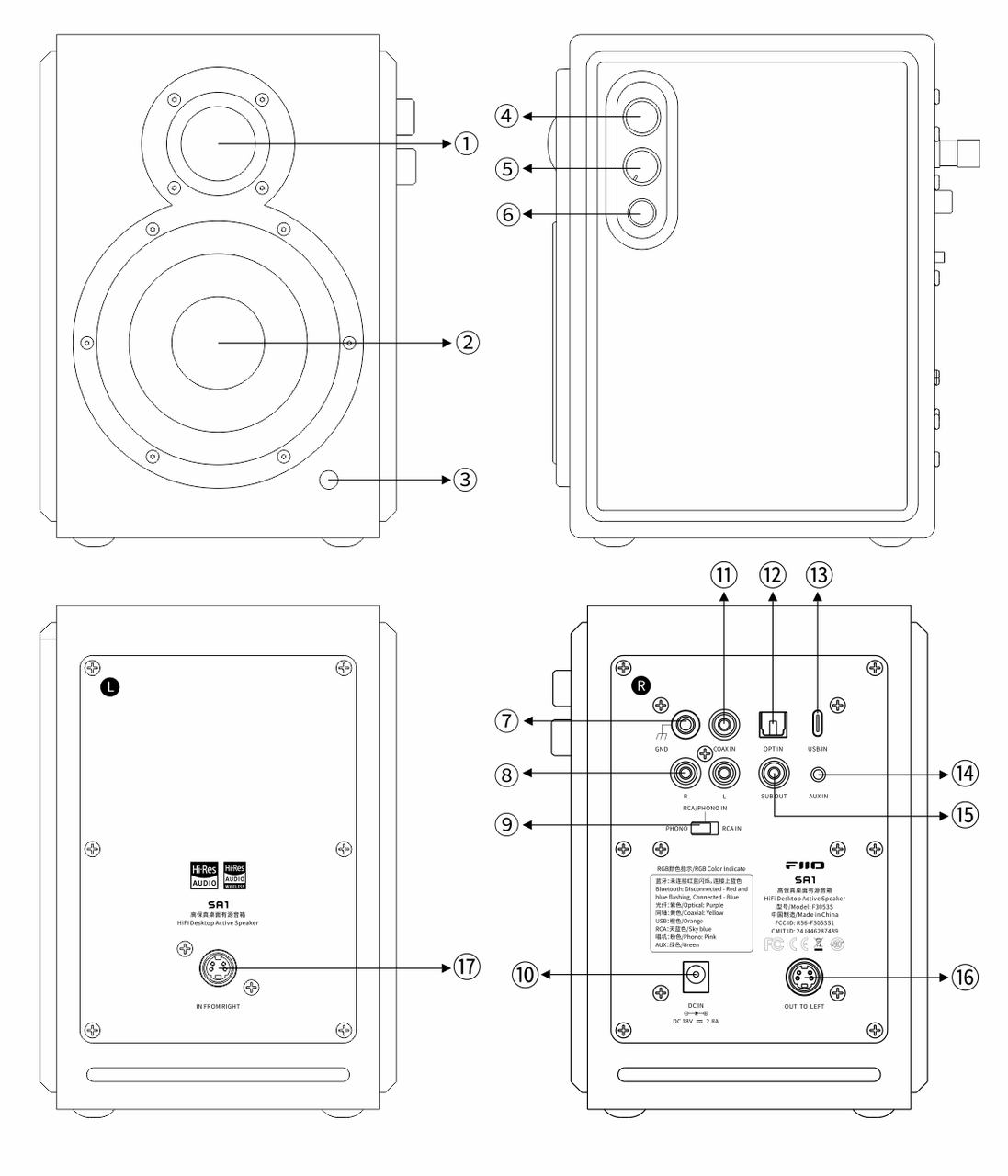

5. Ports labeled and function explained
1.High frequency driver unit
2.Low frequency driver unit
3.Remote control receiving window
4.Signal input button and volume adjustment knob
5.Low frequency adjustment knob
6.Power switch
7.phono grounding post
8.RCA/PHONO input connector
9.RCA input and PHONO input switch
10.DC power input connector
11.Coaxial input connector
12.Optical fiber input connector
13.USB input connector
14.AUX input connector
15.Subwoofer output connector
16.Main box output connector
17.Sub box input connector
【BASS】Bass adjustment
With 80Hz as a reference, it supports an 5dB continuous adjustment range
【POWER】Power on/off button
Power on (long press): RGB light on
Power off (short press): RGB light off
