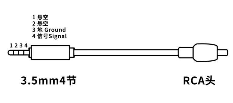

b. If the playback has no sound, it is recommended to set the system settings - Audio - SPDIF OUT, to D2P.
c. The definition of the coaxial cable:
