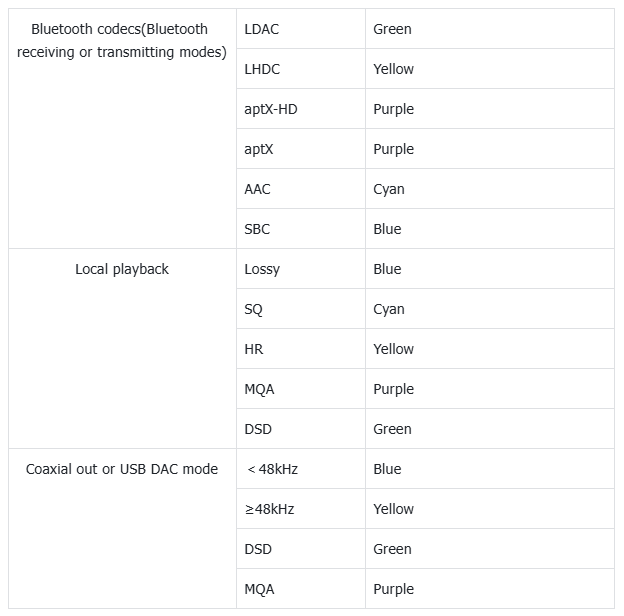

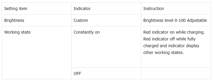

22.M21 indicator light description
The indicator colors corresponding to the different states of M21 are shown below:
Note: MQA support will be added in later firmware update.
