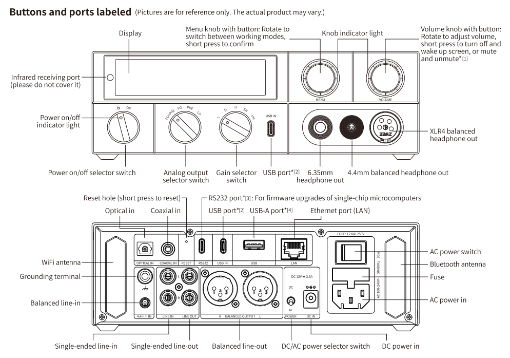

5. K15's signal input and output method description
*Note [1]: The volume knob's short press function for screen off/wake-up or mute/unmute will only take effect after being set in the menu.
*Note [2]: If the two USB ports on the front and rear panels are connected, the front one will prevail, and the rear one will be disabled.
*Note [3]: Adjusting the equalizer via the webpage requires connecting to the RS232 port on the rear panel.
*Note [4]: The maximum output current of the USB-A port is 500mA,which is suitable for connecting to a USB flash disk. If you need to connect to a mobile hard disk drive, please use an extra power supply to power it.

K15 supports USB input, coaxial input, optical input, line input, balanced input, Bluetooth input, streaming, local playback, a total of 8 input modes. You can use the remote control or the front panel menu knob to remotely switch the input mode.
[Input Priority]
USB input: Front panel USB input port > Rear panel USB input port
Other input modes can be switched by knob control menu selection, infrared remote control or FiiO Control APP.
Airplay and ROON: The now operating mode will have priority. For example, if you connect ROON to play songs first, and then your phone is connected to airplay. The K15 will switch to airplay mode.
[Output supported by K15]
K15 supports 6.35mm single-ended output, 4.4 balanced output, XLR4 balanced output, RCA line output (LINE OUT), balanced line output (BALANCED OUT) a total of five output modes.
[Output Priority]
[PO] front panel output:4.4mm, 6.35mm and XLR4 balanced output, with the same priority, can be output at the same time. But it is not recommended to use it for a long time at the same time, especially when the impedance of the two earphones is quite different. The output volume may be too loud and can cause the low-impedance headphones in it to overload and cause damage.
[LO] or [PRE] rear panel output:LINEOUT and BALANCE OUT can be output at the same time.
[PO+PRE] the output ports in the front and rear panels have output at the same time; the volume is adjustable.
