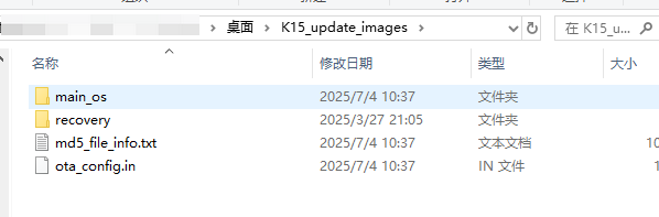

Recovery Steps:
1.Download the latest firmware from the official website.
2.Copy the .zip file to a USB drive and unzip it manually. Then rename the unzipped folder to K15_update_images (do not modify file hierarchy).
3.Insert the USB drive into the rear USB-A port and power off the K15 completely.
4.Hold the RESET button and then turn on the AC power switch (keep holding RESET). Release RESET once the black "Updating" screen appears.
5.Wait for about 10 minutes for firmware upgrade completion and the device will auto reboot.

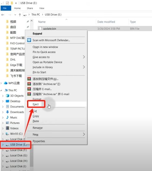

[MCU firmware upgrade instruction]
MCU firmware upgrade video instruction: https://youtu.be/WN-fyWZ53fQ
1.Download the MCU upgrade package to your computer (the upgrade package is a file with suffix ".bin").
2.Connect the RS232 port in K15 to the computer with a USB cable.
3.Select MCU Upgrade from Settings-Others - FW Update-MCU upgrade. There will be a USB flash disk shown in the computer now. Copy the upgrade package to the root directory of the USB flash disk. Then eject the USB flash disk in my computer and the upgrade will start automatically. After the upgrade is completed, the system will reboot automatically.
