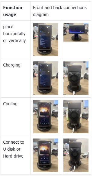

24.How to us the DK1Plus stand fan comes with the M27?
For optimal charging with the DK1 PLUS dock, please remove the coaxial/optical dust plug from your M27 before placing it on the dock. If you choose not to remove the dust plug, gently press the device down after docking to ensure proper contact and normal operation
Note:
1.It is recommended to connect via USB 3.0 port连接方式,推荐usb 3.0口
2.Please turn of CHARGE switch before removing the M27
3 The ultra high gain mode could be enabled via the adapter supports PD2.0 or above fast charging
4.If the M27 is not recognized, please press the device down after docking. It is recommended to remove the coaxial/optical dust plug from your M27for better compatibility.
