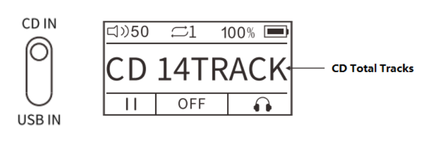

12. How to Use the Onboard Playback Function of the DM15 R2R?
1.Turn on the DM15 R2R, push the input selector switch to CD IN mode.
2.Select the desired output mode and briefly press the Play button.
Under PRE OUT mode, both the front and rear 4.4mm/3.5mm analog output ports will output audio simultaneously.
Notes:
1.When switching to CD IN mode, allow about 5 seconds for disc reading (this is normal).
