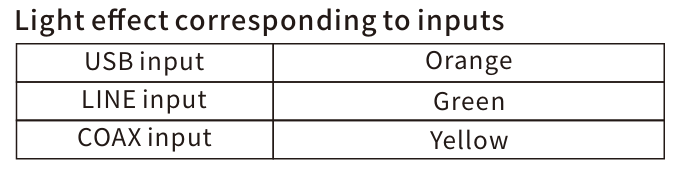

1.Short press the volume knob to switch to the corresponding input mode. The corresponding indicator light colors are shown below:

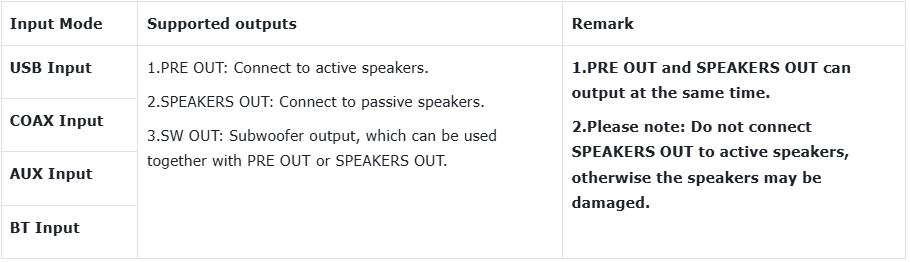

3.Play music from the audio source and adjust LEVEL 1 to a suitable volume. No output switching is required. Once connected to the corresponding output port, audio will be output automatically.
LEVEL 1 Input and Output Instructions
