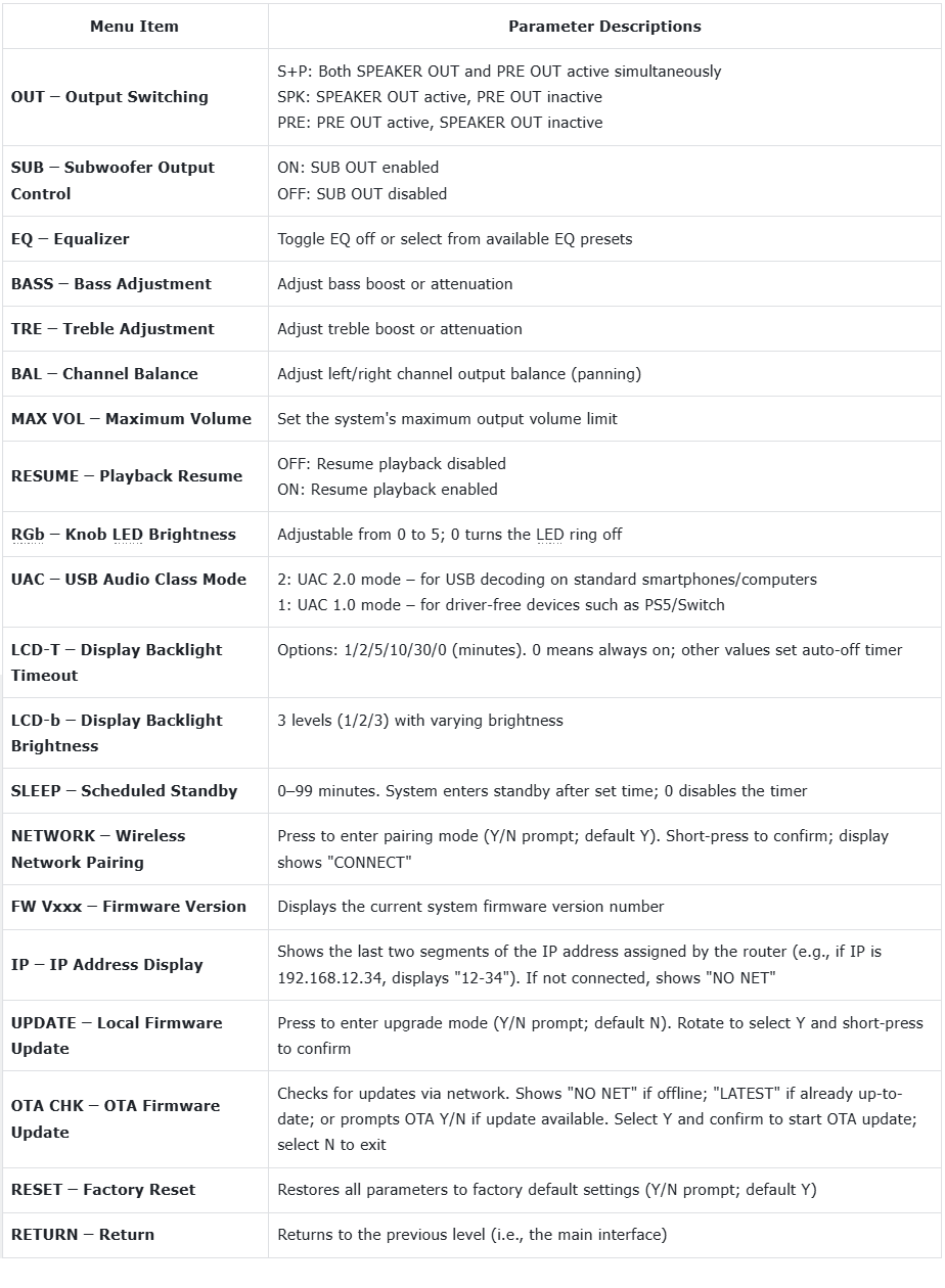

Settings Menu Instructions

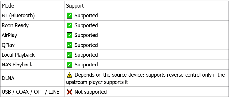

Which operating modes support the Previous Track, Play/Pause, and Next Track buttons on the IR remote?
These transport control buttons (Previous, Play/Pause, Next) are functional in the following modes:
Note: In DLNA mode, support for remote control playback commands depends on whether the front-end player (e.g., the casting app or media server) implements reverse control functionality. Some apps support it, while others do not.
