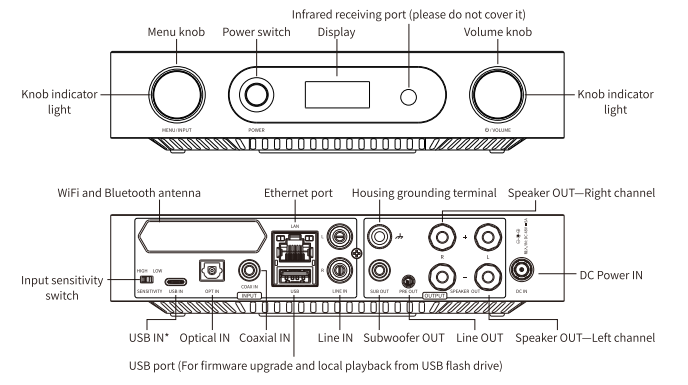

6. Interface Description
Note 1: DC power jack, specification: 7909.
Note 2: USB Type-A port power output: 1.3A.
Note 3: The SENSITIVITY interface is active only in LINE IN mode and is inactive in other operating modes.
Note 4: When connecting speakers, it is strongly recommended to connect the speakers to the AIR AMP while the unit is powered off, and then power it on afterward. This prevents impact noise to the speakers or triggering the "HOT" warning if the wiring touches the chassis or other exposed metal parts during connection.
Function of the Rear Panel Grounding Post
  1. When the AIR AMP is used with other devices that do not have a grounded power connection, they can be connected via the grounding post.
  2. The grounding post can be used to directly connect the AIR AMP's metal chassis to earth ground, improving the device's ESD (electrostatic discharge) immunity.
  3. It may help improve ground loop issues and potentially reduce loop-related interference.
