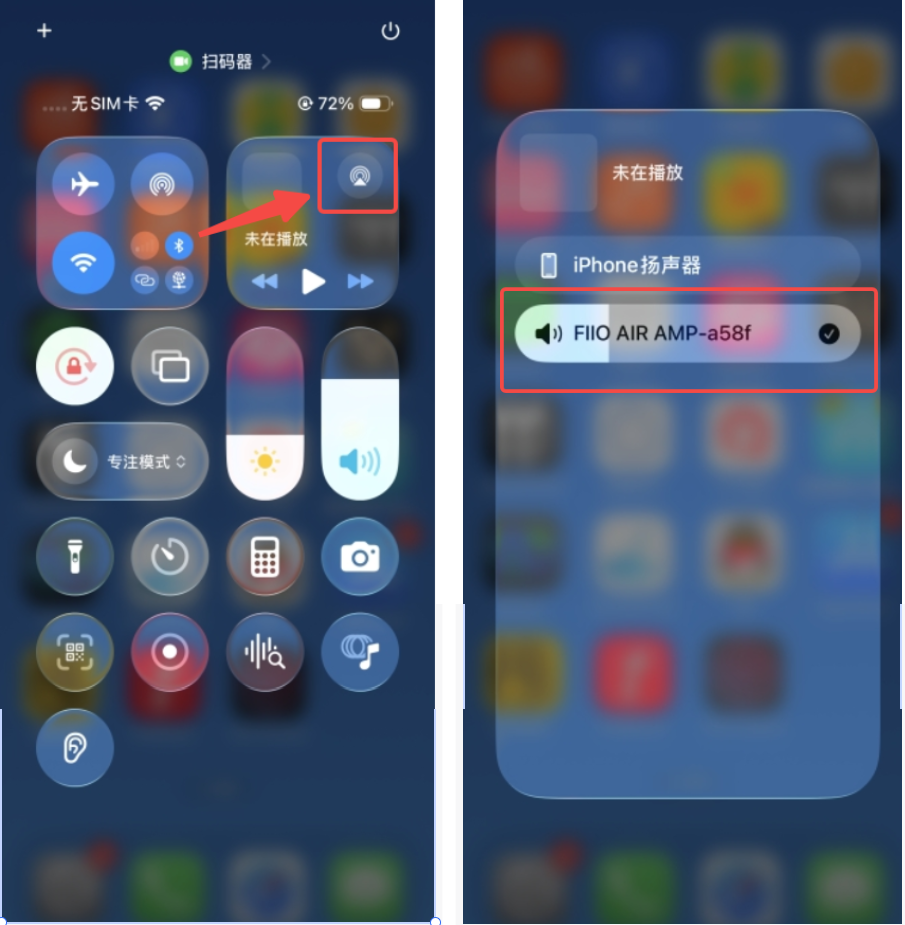

1. After powering on the AIR AMP, rotate the menu knob on the main interface to enter mode selection, rotate to switch to STREAM mode, and short-press the knob to confirm.
2. Confirm that the AIR AMP has been connected to the network and that the iPhone and the AIR AMP are on the same network, and connect the corresponding audio output devices.
3. On the iPhone, pull down the Control Center, tap the audio playback device, and select the AIR AMP as the audio receiving device. Play any app on the iPhone, and the sound will output from the AIR AMP. Rotate the volume knob on the AIR AMP to adjust to the desired volume.
