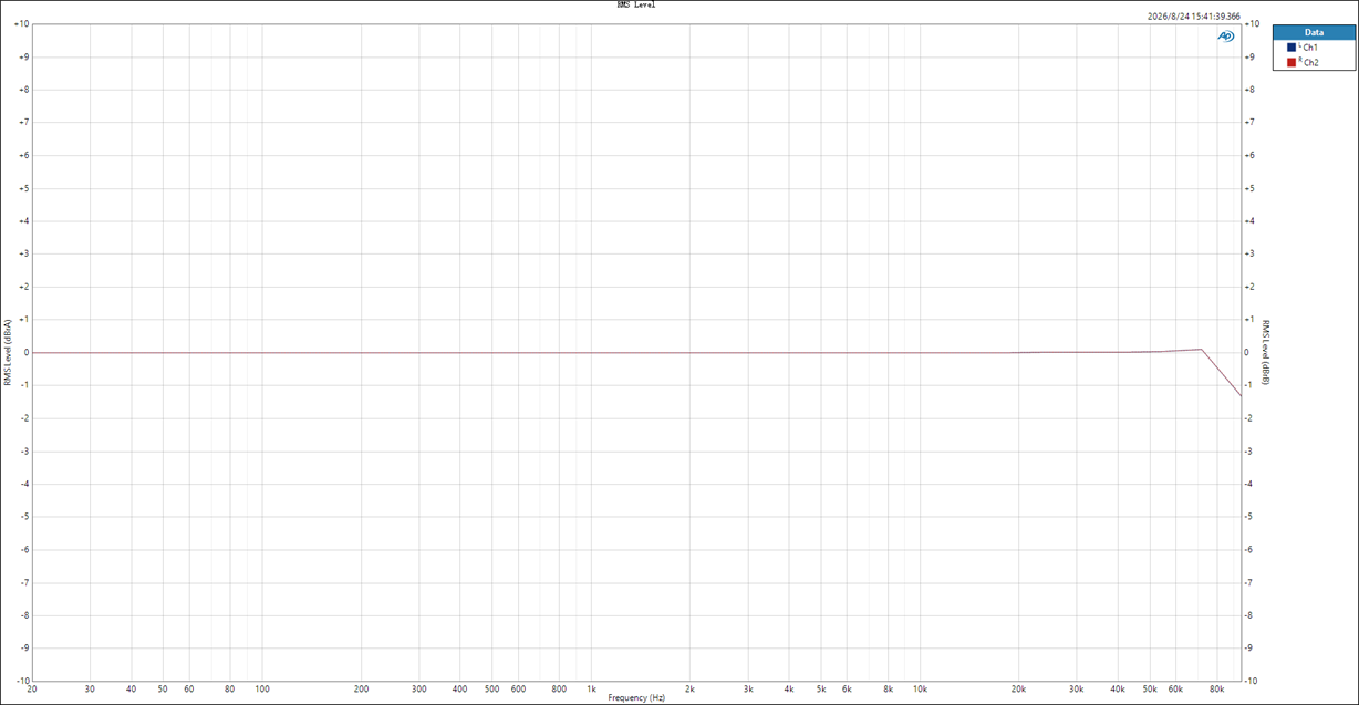

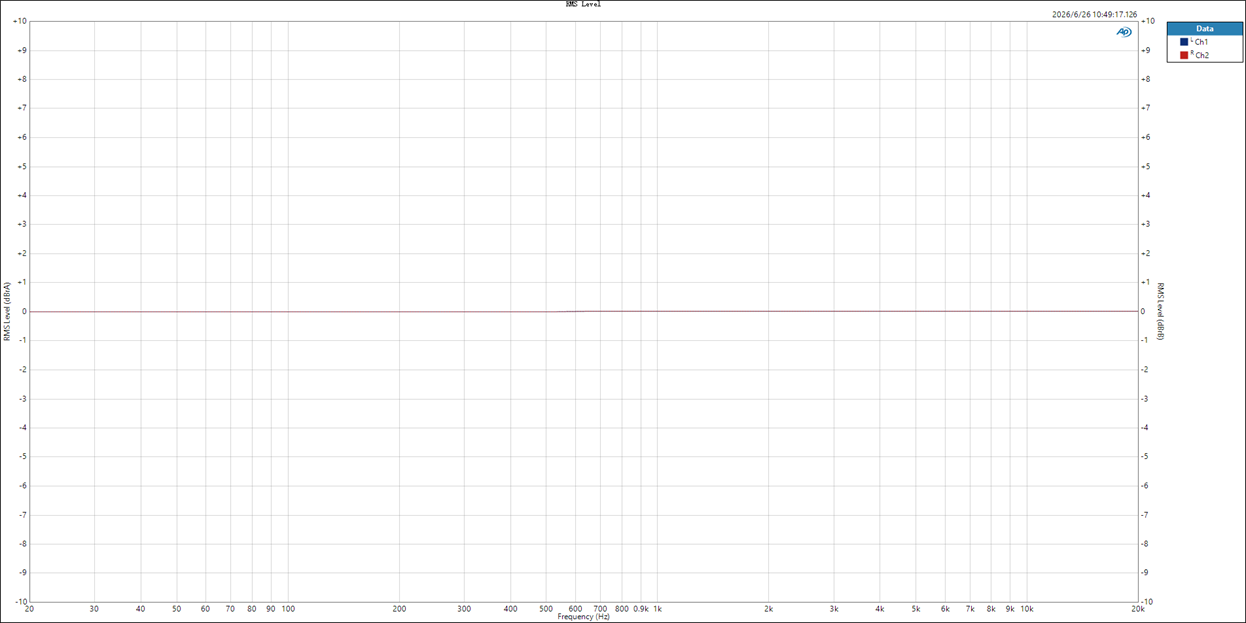

线性输入频响曲线 / Linear Input Frequency Response Curve
Test conditions: -5dBV sinusoidal signal, 20Hz–20kHz, Headphone out, Ultra high gain mode (32Ω load)
Test conditions: -5dBV sinusoidal signal, 20Hz–20kHz, Balanced headphone out, Ultra high gain mode (32Ω load)
Test conditions: -8dBV sinusoidal signal, 20Hz–95kHz, Headphone out, Ultra high gain mode (32Ω load)
Test conditions: -5dBV sinusoidal signal, 20Hz–95kHz, Balanced headphone out, Ultra high gain mode (32Ω load)
Test conditions: -5dBV sinusoidal signal, 20Hz–20kHz, Headphone out, Super high gain mode (32Ω load)
Test conditions: -5dBV sinusoidal signal, 20Hz–20kHz, Balanced headphone out, Super high gain mode (32Ω load)
Test conditions: -8dBV sinusoidal signal, 20Hz–95kHz, Headphone out, Super high gain mode (32Ω load)
Test conditions: -5dBV sinusoidal signal, 20Hz–95kHz, Balanced headphone out, Super high gain mode (32Ω load)
Test conditions: -5dBV sinusoidal signal, 20Hz–20kHz, Line out (10kΩ load)
Test conditions: -5dBV sinusoidal signal, 20Hz–20kHz, Balanced line out (10kΩ load)
Test conditions: -5dBV sinusoidal signal, 20Hz–95kHz, Line out (10kΩ load)
Test conditions: -5dBV sinusoidal signal, 20Hz–95kHz, Balanced line out (10kΩ load)

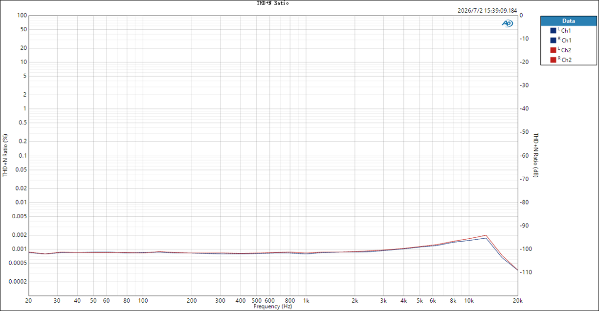

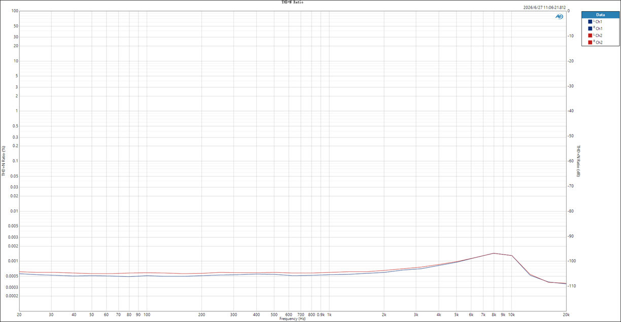

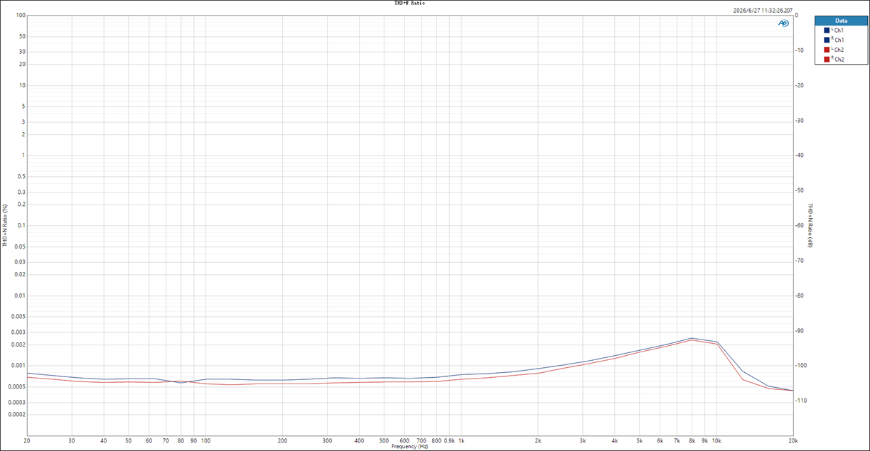

线性输入失真曲线/ Linear Input Distortion Curve
Test conditions: -0.6dBV sinusoidal signal, Headphone out, Ultra high gain mode (32Ω load)
Test conditions: -3.2dBV sinusoidal signal, Balanced headphone out, Ultra high gain mode (32Ω load)
Test conditions: 1.6dBV sinusoidal signal, Headphone out, Super high gain mode (32Ω load)
Test conditions: -0.8dBV sinusoidal signal, Balanced headphone out, Super high gain mode (32Ω load)
Test conditions: 0dBV sinusoidal signal, Line out (10kΩ load)
Test conditions: -2dBV sinusoidal signal, Balanced line out (10kΩ load)

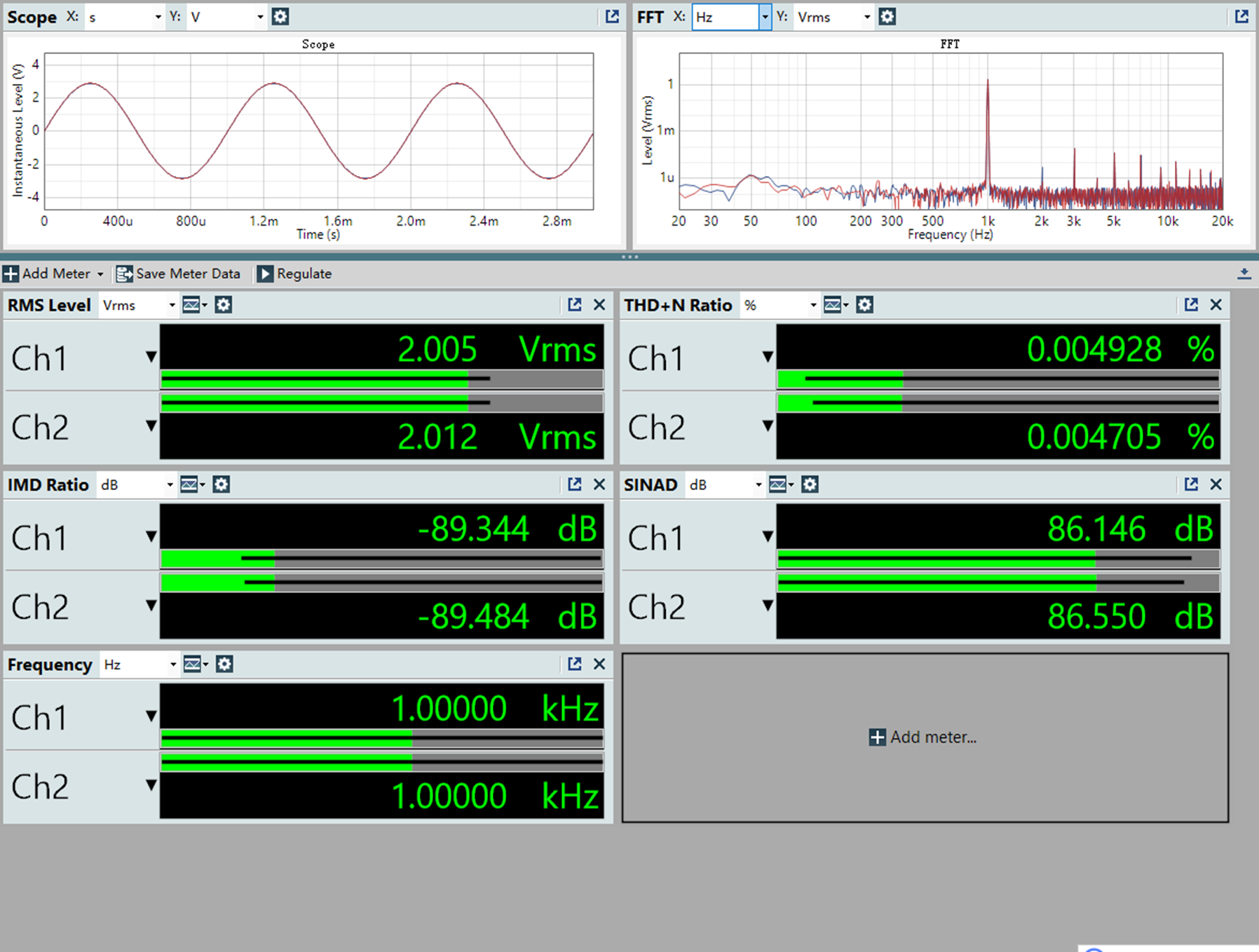

PO Ultra High Gain Mode Output 2V@32
PO Super High Gain Mode Output 2V@32Ω
PO Medium Gain Output 2V@32Ω
PO Low Gain Output 1V@32Ω
BAL PO Ultra High Gain Mode Output 4V@32Ω
BAL PO Super High Gain Mode Output 4V@32Ω
