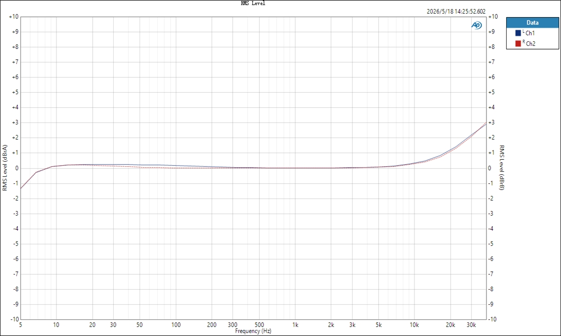

| Audio Parameters |
| Performance and parameters of speaker output (53V/12A Power supply, Line in, Bass/Treble level 0) |
| Output power 1 |
L+R≥300W+300W (4Ω, THD+N<10%, 36.5Vrms) |
Output impedance |
<0.2Ω (4Ω) |
| Output power 2 |
L+R≥190W+190W (8Ω, THD+N<10%, 39Vrms) |
Crosstalk |
≥87dB (1kHz@4Ω) |
| Output power 3 |
L+R≥240W+240W (4Ω, THD+N<1%, 31Vrms) |
Noise floor |
<90μV (A-weighted) |
| Output power 4 |
L+R≥135W+135W (8Ω, THD+N<1%, 33Vrms) |
SNR |
≥111dB (A-weighted) |
| THD+N |
<0.0025% (1kHz/-9dBV@8Ω) |
Dynamic range |
≥106dB |
| Frequency response |
5Hz~40kHz |
Peak output voltage |
>100Vp-p |
| Output power 1 |
L+R≥120W+120W (4Ω, THD+N<1%, 29.7Vrms) |
Output impedance |
<0.2Ω (4Ω) |
| Output power 2 |
L+R≥115W+115W (8Ω, THD+N<1%, 33.5Vrms) |
Crosstalk |
≥87dB (1kHz@4Ω) |
| THD+N |
<0.0025% (1kHz/-9dBV@4Ω) |
Noise floor |
5Hz~40kHz |
SNR |
≥108dB (A-weighted) |
>90Vp-p |
Dynamic range |
≥103dB |

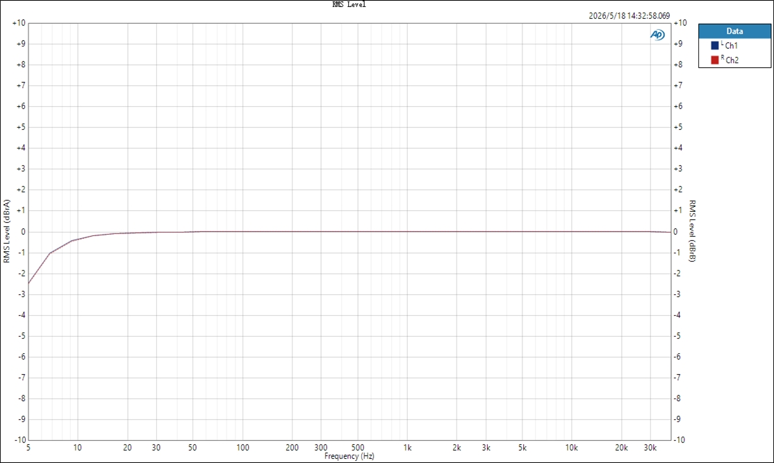

| Performance and parameters of single-ended line output (Line in, Bass/Treble level 0) |
| THD+N |
<0.00035% (1kHz/-2dBV@10kΩ) |
SNR |
≥115dB (A-weighted) |
| Crosstalk |
≥108dB |
Noise floor |
<4.6uV (A-weighted) |
5Hz~40kHz |
Dynamic range |
≥112dB |
| Line output level |
2.5Vrms (1kHz@10kΩ) |
