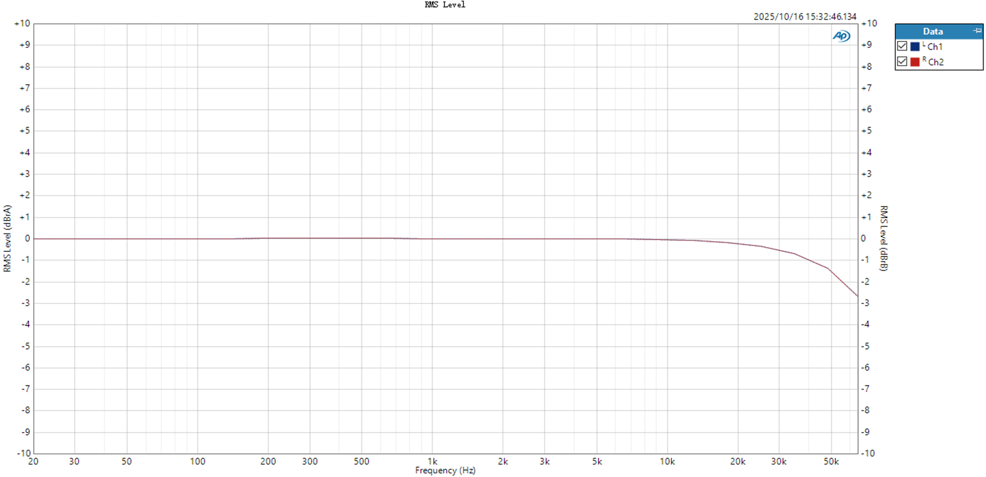

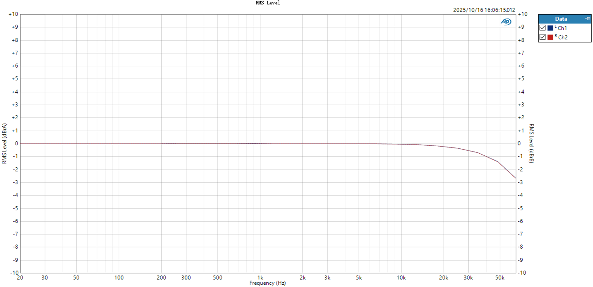

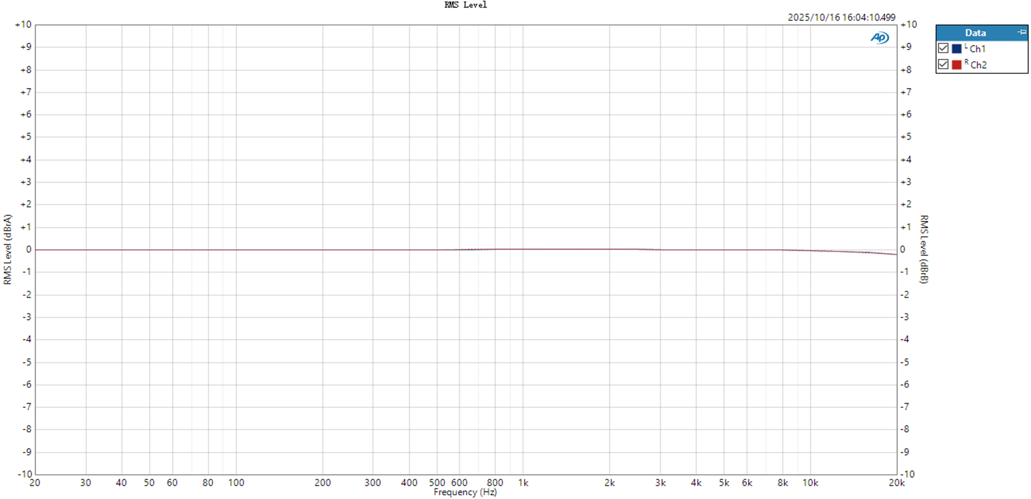

USB, Coaxial, Optical Frequency Response Curves
Test conditions: Oversampling 192K, -5dB sinusoidal signal,20Hz-20kHz,RCA line out (10kΩ load)
Test conditions: Oversampling 192K, ,-5dB sinusoidal signal, 20Hz-65kHz, RCA line out (10k load)
Test conditions: Oversampling 192K, -5dB sinusoidal signal, 20Hz-20kHz, XLR3 balanced line out (10kΩ load)
Test conditions: Oversampling 192K, -5dB sinusoidal signal, 20Hz-65kHz, XLR3 balanced line out (10kΩ load)

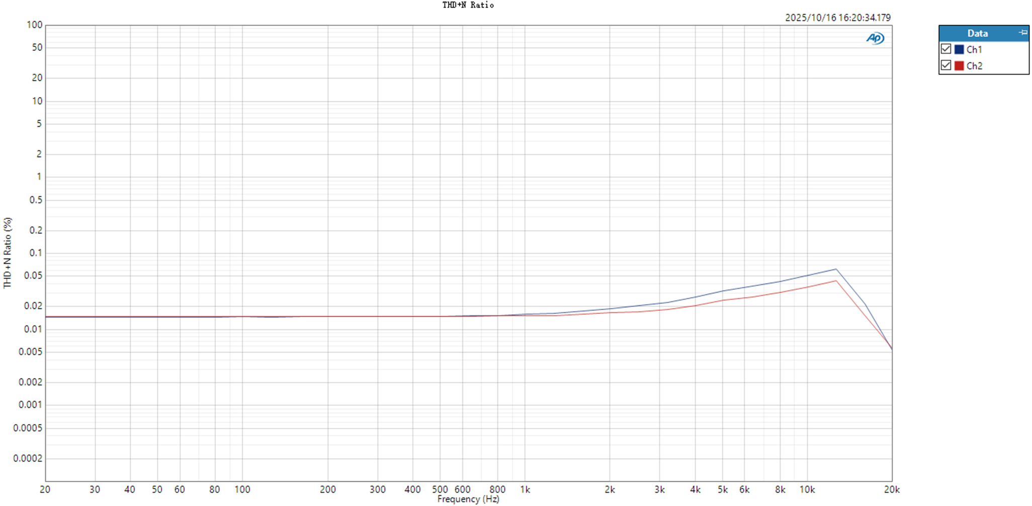

USB, Coaxial, Optical Distortion Curves
Test conditions: Oversampling 192K, -0dB sinusoidal signal, RCA line out (10kΩ load)
Test conditions: Oversampling 192K, -0dB sinusoidal signal, XLR3 balanced line out (10kΩ load)
